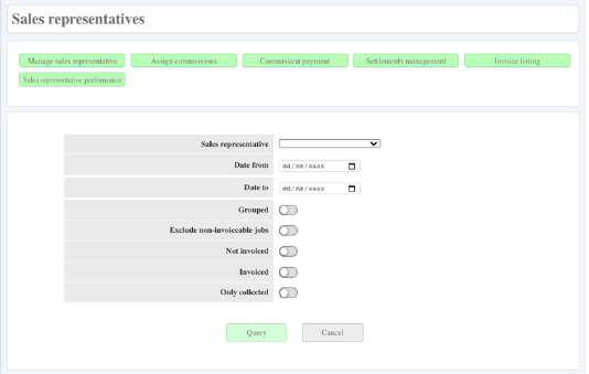

• field sales representative. We select the sales representative whose report we would like to obtain. If we do notselect any, the query is launched against all the sales representatives.• date field from. We enter the job completion date from which we would like to query the jobs.• date field until. We enter the job completion date from which we would like to query the jobs.• selector grouped. We tick this selector if we want to group a query by sales representative, that is, a query withall the jobs assigned to that sales representative. And if we are retrieving the report for all sales representatives,grouped means that all the jobs assigned to each of the sales representatives are grouped according to the totalamounts.• selector exclude non-invoiceable jobs. We tick this option if we do not wish to include the non-invoiceable jobsin the query. At some point this may be useful if we want to pay a sales representative commissions for what hasbeen or will be invoiced, excluding items that will never be invoiced.selector not invoiced. We tick this option if we do not wish to include the invoiced jobs in the query. For example,let us suppose we would like to know how much the sales representative has produced but not yet been invoiced.• selector invoiced. We tick this option if we want to include only the invoiced jobs in the query. For example, let ussuppose we would like to know how much the sales representative has produced and already been invoiced.• selector only collected. We tick this option if we want to include only the collected jobs in the query. For example,let’s suppose we would like to know what has already been collected from the sales representative’s achievedsales. Most companies pay for what has been collected and invoiced.

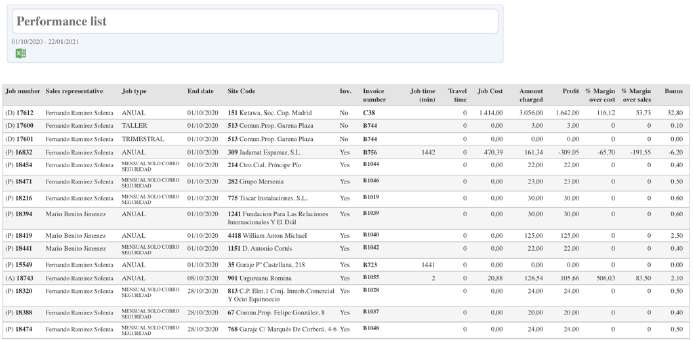

• If a sales representative has been selected but the query has not been grouped, we will obtain a report containingthe following information:
- the job ID, indicating the job type (recurring, dependent, call-out) and its number (through which you canaccess the Task record)- we enter the sales representative’s name.- the job type: monthly, annual etc., corrective, maintenance and so forth.- the job completion date- the site client where the job was carried out: reference number (from where we access the Site client)and name- whether or not it is an invoiceable job- the invoice number, if available (from here we can access the invoice)- the job time in minutes- the travel time in minutes- the cost of job = [("minutes travelled" + "minutes worked") x "technician cost"] + "cost of purchasing theproducts supplied for the job".- the amount charged to the client. It is established by the resources, materials, operations and fees thatare charged to the client at the sales price- the profit = "amount charged" - "cost of work".- % margin over cost. Profit is calculated on the "cost of work"- % margin over sales. Profit is calculated based on "the amount charged the client"- Bonus. A bonus is a unit to measure the profit of the work that our company has carried out. In the currentsoftware version, the bonus represents a standard amount calculated in relation to the gross margin. Infuture software versions, the value of the bonus will be assessed by our company; this allows us to evenoffer a different value depending on the job type.Also, in future G3w versions, sales representatives will be able to view the technician ranking basedon bonuses obtained on a day, in a week, a month or a year, and thus see what position they are incompared to others in the company. Because they do not know the value of the bonus, they do not haveaccess to the gross margins at our company.
• If we have chosen a sales representative and selected the option group the result, we obtain a report containing:- the amount of jobs carried out that are linked to that sales representative- the total time of the jobs in minutes- the total travel time in minutes- the total cost of the jobs = [("minutes travelled" + "minutes worked") x "technician cost"] + "purchase costof products supplied for the job".- the total amount charged to the client. It is established by the resources, materials, operations and feesthat are charged to the client at the sales price- the gross margin = "amount charged" - "cost of work".- % margin over cost. Profit is calculated on the "cost of work"- % margin over sales. Profit is calculated based on "the amount charged the client"- Bonus. A bonus is a unit to measure the profit of the work that our company has carried out. In the currentsoftware version, the bonus represents a standard amount calculated in relation to the gross margin. Infuture software versions, the value of the bonus will be assessed by our company; this allows us to evenoffer a different value depending on the job type.
- the sales representative’s name- the amount of jobs carried out that are linked to that sales representative- the total time of the jobs in minutes- the total travel time in minutes- the total cost of the jobs = [("minutes travelled" + "minutes worked") x "technician cost"] + "purchase costof products supplied for the job".- the total amount charged to the client. It is established by the resources, materials, operations and feesthat are charged to the client at the sales price- the gross margin = "amount charged" - "cost of work".- % margin over cost. Profit is calculated on the "cost of work"- % margin over sales. Profit is calculated based on "the amount charged the client"- Bonus. A bonus is a unit to measure the profit of the work that our company has carried out. In the currentsoftware version, the bonus represents a standard amount calculated in relation to the gross margin. Infuture software versions, the value of the bonus will be assessed by our company; this allows us to evenoffer a different value depending on the job type.This information can also be exported to Excel.
