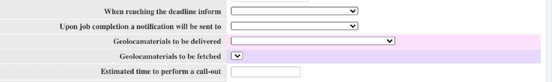

The delivery jobs and the pickup jobs of geolocatable materials are treated like call-outs, and are generated from the Main
menu / button clients / selector site clients / button call-out. We access the screen Call-out generation where we fill in
all the information necessary to create the job. There are 2 specific fields for the jobs related to managing geolocatable
materials:
• field geolocamaterials to be delivered. It is a drop-down field that displays all the geolocatable materials flagged
with the "in the warehouse" status.
• field geolocamaterials to be fetched. It displays all the materials flagged with the "at the client’s site" status.
